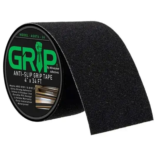

Grip tape.
grip tape
https://www.homedepot.com/p/4-in-x-34-ft-Anti-Slip-High-Traction-Safety-Grip-Tape-for-Stairs-Steps-Ladder-MA-ASGT-4-34/312387533?NCNI-5
You can see it is tape on one side and sand embedded in matrix on the other. We had some of this on the front porch for years. It is cheap and quick. I imagine like any other solution of this sort durability will have to do with how much sunlight strikes the tape on a daily basis. A nice thing too is you can see if it is wearing out, and replace it.
