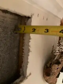

EDIT: I am in a townhouse and we do not know if there is a single row of blocks between the units or two. We also do not know if they are filled or not. There is good but not perfect sound isolation between the townhouses and this is an adjoining wall. Here is a picture of what it looks like:

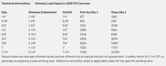

The table below snipped from one manufacturer's specs would show the 3/8" anchors you're considering are specified for 1-1/2" embedment, at 1-1/4" you're a little shy. If you get some blowout / mushrooming when the bit goes through the block - which you can't see, but almost always happens - you'll have less than 1-1/4" embedment.

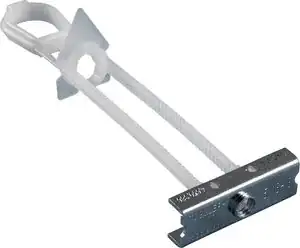

All this in mind, hands down I would recommend using 1/2" Snaptoggles or similar product. Traditional spring loaded toggles would probably be fine but this newer style toggle is much easier to work with for this type of application, and stronger. They have a rating for block, and are rated for 2,038 pounds of pullout tension in block with high grade bolts.
These are easy to use and are much more forgiving than wedge anchors etc. if your hole is a little ovaled or oversized. The hole for a 1/2" Snaptoggle is 3/4" giving you a little wiggle room with the placement, so no need to undersize the anchor. You can use them with 6" bolts if you want. If you remove or relocate the equipment some time in the future, you'll not be left with a stud you have to cut off - you can just unscrew your bolts and patch the holes.
