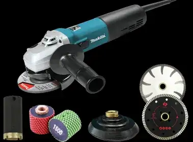

This one's $500, but it's how it's done. I don't remember mine being so expensive; shop around. On the far left is the core bit you don't need. Second and third are the core polishers that you do: "Dia-Plus Resin Drum Wheel: Wet" except both of those in that kit are 2 inch.
You'll (really) want a badass grinder like that (variable speed and has a 12 AMP motor), and a drum wheel that will fit in your hole. My kit came with smaller drums; everything you'd need (not pictured; might be from Bosh, IDK...).
Sink Cutting and Polishing Package
