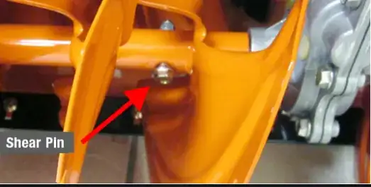

Here's a close up of the installation of a shear pin/bolt that is designed to break. Each side of the gearbox will have at least one. If your snowblower is a three-stage unit, there will be more.

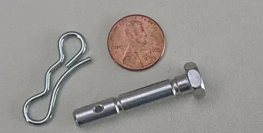

Here's a close-up of a replacement supplied with a Cub Cadet. You can see it uses a clip to install and the notches designed to break are obvious. They are 1/4" diameter and about 1-1/2" long. Even though my three-stage snowblower uses four in total, Cub Cadet only gave me three spares.
