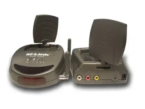

Have you thought about trying to achieve the same result without running wires? Assuming you're using a cable (or satellite) box of some kind (and your TV doesn't have a built-in cable card), you could use something like this:
Wireless A/V transmitter
That would give you a standard RCA connection from your satellite/cable box to your TV. There are other options for other connection types; e.g. this one for HDMI (although it gets spendy).

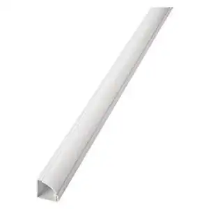

Failing that, how about just using a quarter-round cable cover around the edge of the room?

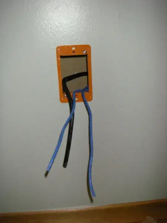

Why don't you ask the landlord, and just leave it installed? If you use a low-voltage retrofit mount in the wall, a nice faceplate, put it in a reasonable spot, keep the wiring in the basement nice and neat (eg, stapled down) and leave the other outlet intact, I wouldn't think this would be a problem. Heck, most landlords probably do not keep track of where outlets are and would probably not even notice (unless it was crooked, mounted unevenly, or generally there is something calling attention to it).
low-voltage retrofit box
coax faceplate
(note: this is one I did that also has ethernet, but you can get faceplates with a single coax in the middle)
