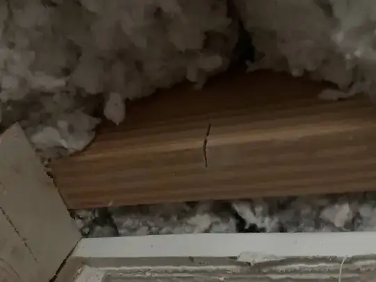

Accidentally cut the bottom chord of truss. It happens on the corner of the stud and not fully cut through as picture showing. If I would like to fix it, which contractor should I contact? And would the repair make it even worse since there may need to use screws? Great thanks. enter image description here

No contractor needed. Cut a piece of 1/2" plywood 3-1/2" X 12", drill 10 screw holes in it, slather it with glue and screw it on there. Might be overkill, but should do the job.
14
If you need to fix this so you can sleep better at night, any carpenter would be able to sister this truss for a repair. In my humble opinion though, no repair is needed. If you look around up there, there' a good chance you'll see notches cut all the way through for cables, conduit, pipes, etc.

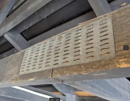

A strong-tie splice would work very well here. Here's one in my home that was used to splice beams for a bottom chord.
