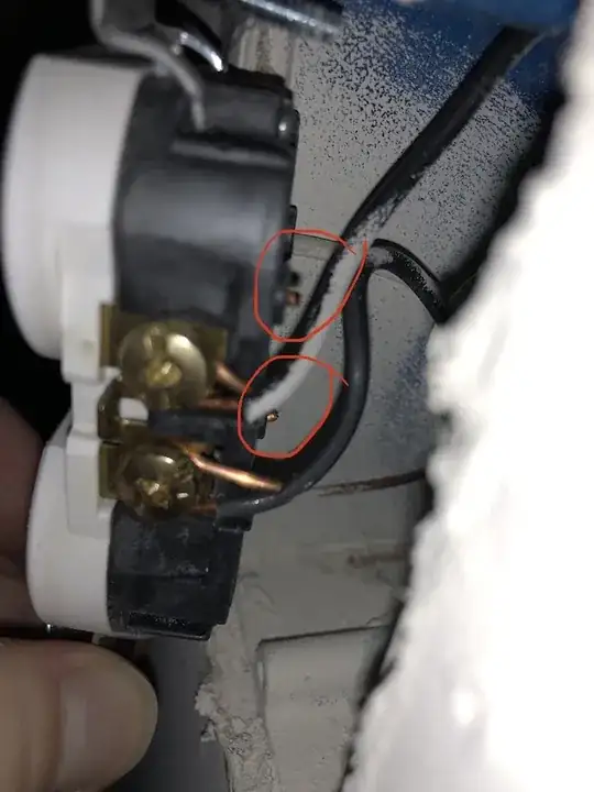

A number of years ago I had our electrician change all of our quick wired/back stabbed outlets in our new home to the screw terminals for better and safer connections.
Recently I discovered he didn’t bother to remove them completely but rather cut them as close to the openings in the back as possible before moving the wires to the screws.
I’m a bit concerned given these wire stubs would technically still be live and may have the same arcing/connection issues as before since they will cool and heat along with the other internal components of the outlet.
Is this not the case? Am I over thinking this?
Any thoughts appreciated.

A sloppy job, but you're overthinking it.
Having been cut, no current is flowing through the backstab, so no heating, no arcing, no problem other than if you handle the outlet while the circuit breaker is on and fail to respect the short stubby live wires poking out the back. Since it's generally inadvisable to play with receptacles out of their box with the circuit breaker on, not usually a problem.
