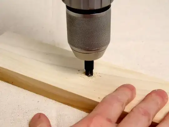

  • try to make a drill guide. The image here shows a simple hole in wood that you can firmly hold against the wall to help keep the drill at the same starting point.You will obviously need someone to hold this against the wall.

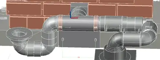

Here are a few ideas. If you have enough tools and can figure out how to do it, maybe you can make a jig with a square piece of plywood. Drill a hole the size of your brick but through that. Figure a way to locate the jig so the hile is where you want it in the brick, then start your hole through that. The jig should prevent the bit frim wandering--if you can hold it steady. Also, I didn't notice anyone mentioning a carbide tip bit, let alone a tapping drill. better at least get a carbide tipped bit for this.
I haven't tried this yet, but am facing the same problem.
I'll probably use concrete nails as a hole punches once the centers are located. I may combine this with the suggestion of making a hole template, but accurately drive the concrete nails into the wood so they align to the exact center of a pair of slots.
In my case, since this involves a drainage pipe, I'll place the template with the correctly placed concrete nails on the slab that underlies a brick surface and an aligned curb. (I hope you can visualize this.)
What needs to be mounted is a pipe support of sheet metal. I can,in my case, use clamps to secure the template to the curb and the slab underneath. when all is in place I'll gently hit the nails further into the wood template, thus striking the slab.
Of course the wood template can be any size, dependent on the needs of the project. A level can be run across the heads of the nails in the template for correct horizontal placement when secured to the curb with clamps. In my case a slight down angle for drainage is required. For others double sided tape could be used for accurate placement of the template.
I'll achieve required placement since the adapter in the brick curb will be held in place with GE Silicone II. At this point it is not hot glued to the rest of the pipe, which can be positioned correctly for drainage. Lines drawn through the centerlines of the concrete nails will be used to make additional sight holes to another set of lines on the sheet metal pipe support so the punch marks made by the nails will be in the exact center of the slots. The slots will allow 3/8" of angular slope between the slots in either direction. Thus will also have another allowance for accuracy of threaded rods epoxied into the holes which will be oversized allowing an additional amount of accurate positioning until the epoxy sets.
It sounds complicated, but so is being a little bit off center.
View showing slotted holes to be held by threaded rods epoxied into slab.
