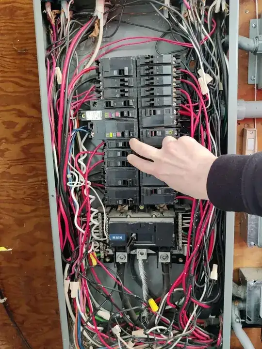

enter image description hereenter image description hereI was recently trying to upgrade a 20A breaker supplying outlets in my kitchen and dining room to a CAFCI breaker. When I opened my breaker box I saw that the neutral on this circuit was shared with an adjacent breaker, which supplies our kitchen refrigerator. This setup does not seem particularly safe (noted when I disconnected the outlet breaker and the neutral was sparking when I tried to disconnect it from the busbar). From reading around, it seems that the outlet and fridge breakers should have a handle tie since this is a MWBC. Is this correct? If so, can I replace both breakers with a double pole CAFCI breaker? Is it okay to have a fridge and kitchen outlets powered from the same breaker? Thanks in advance!

Now look at those "double-stuff" breakers in your panel's upper right. Those fit in 1 space, which attaches to 1 pole (leg). That means you have the same leg on both half-breakers. That sounds like a TERRIBLE thing to put an MWBC on, doesn't it? Yet, thisis a very common blunder.

You need to go through this entire panel and identify every MWBC. Look for cables coming in that have both black and red wires. Identify and follow its pigtailed wires. Make sure every MWBC
  • Opposite-phased (240V between the hot legs) at the very least
  • On a handle-tied or 2-pole breaker. (2-pole breakers are $18 because you have the expensive but excellent Square D "QO" type; handle-ties will be cheaper).
  • MWBCs and tandem breakers (like in upper right) are very tricky and dangerous. You may have to confront this issue.
If you need to double-stuff some of your MWBCs for lack of panel space, then call around to real electrical supply houses and find out who is a Square D dealer. Talk to them about your options. There is a type of breaker that is both double-stuff and 2-pole called a "Quadplex", those work with MWBCs, but they are hard to get. They can also advise you on the possibility of handle-tying the inner switches on 2 adjacent tandems.
Your panel is very full - time to start thinking subpanel
This panel is absolutely full. You have no breathing space, even correcting MWBC handle-ties could be a challenge. It might seem like you've only just begun double-stuffing this panel, but they're only allowed in the top 5 rows. 8 of those 10 spaces are already double-stuffed (that thing in row 5 left is an "old school" tandem designed to be installed 2 abreast with handle-ties on one or both; pity you only have the one.)
So you are maxed out.
The problem is you have too few spaces for as much main breaker as you have. This is very common; houses these days really need 50-ish spaces. The builder thought "Oh, this is a 30-space/40-circuit panel, it'll be FINE!" but you know that is not so.
Swapping the whole panel for a 60-space would be mad; that's very expensive and very disruptive. If there is space to the left, you can simply install a subpanel there. Note how things to the right are connected with short nipples of PVC conduit. Do the same thing but with steel conduit, so it carries ground to the sub. And have 1 big pipe (for the feeder wires) and 2 more little ones (they are so very useful, it's sad when people omit them).
Fortunately your panels are all surface mounted, so they're easier to work with.
If you want to put the subpanel somewhere else in the house so you can shorten some cable runs, that's fine too.
As far as brand, QO is of course excellent. If you're thinking future generator, several panels will do. However, here's an interesting tidbit: GE has an AFCI breaker that does not require a neutral wire. It's specifically marketed to work on MWBCs.
Oh yeah... that AFCI
On MWBCs, AFCI is harder because it depends on the existence of 2-pole AFCI breakers from the manufacturer. (QO physically can't take competitor breakers*, but other 1" panels shouldn't because even though they seem to fit, they aren't physically compatible at the bus stab.)
They make a 2-pole GFCI for your panel, QO220CAFIC, but it's a bit hard to find.
Fortunately it's not mandatory since this is old work. (For new work, don't use MWBC unless...)
There's also that GE breaker. Can't put it in anything but a GE panel, but you're due for a subpanel, so that's a thought.
Other than that, your AFCI option is to fit an AFCI receptacle at the first recep location in the chain. That will not provide protection for the cable run from panel to first recep!
* Difference in the shape of the bus stabs makes it bad to put brand X breaker in brand Y panel. However, UL has a certification program for companies making breakers specifically for competitor panels. The only ones I'm aware of are Eaton "CHQ" and Siemens "QD" for QO panels, and Eaton CL for certain 1" wide breaker panels.
