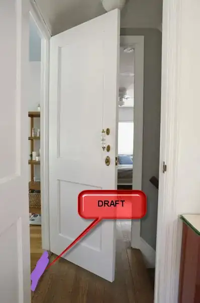

I have a door similar to this, but it is an external door. There is a lot of cold air coming in from the bottom of this door, and around the perimiter (betweent he door and the frame).
This is a rental house, so I don't want to spend too much fixing this forever, just enough for it to be effective.
How do I prevent cold air from coming into the house?

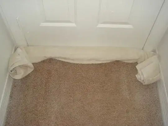

For a temporary, low-cost, low-hassle solution, you could just put a towel down in front of the door to block the draft. That's what we always did in my house as a kid.
towel in front of door
