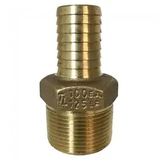

Black polyethlyene pipe (also known as well pipe) for cold water distribution is still very standard and available as are the fittings for it. The folks who make blue polyethlyene well pipe make some dubious claims that it's "better" but I can't say I find them at all convincing, and the price differential is large. The black stuff is listed by NSF as suitable for potable water. So's the blue stuff. They use the same fittings anyway. The rest is marketing BS.

Picture is from Aqua Science, one of many online vendors that have them. A hardware store near you probably also has the correct fittings. I have purchased stuff from Aqua Science but have no other relationship with them.
barbed fitting for poly well pipe
