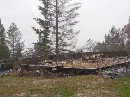

I had a friend of a friend lose his home during these devastating fires in Oregon and California. I am trying to help out and was wondering if the foundation is reusable or not.
Did the fire damage it and weaken it to the point of needing to be redone?
Or can it be re-used? How to tell?
burned house

The answer cannot be determined from a photo. Please consult a structural engineer who can inspect the foundation and determine if it's still suitable for building.
Yes, this will cost something but it's going to be far less expensive than building on a unsuitable foundation. It's also likely that the AHJ is going to require that anyway before issuing a building permit.
