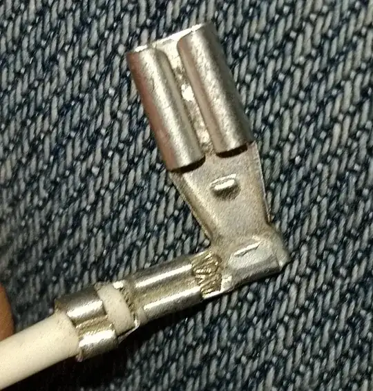

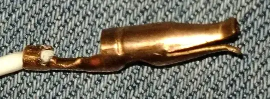

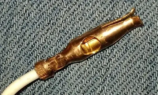

The closest name I found from searching online is "crimp terminals", specifically the first I believe would be "female round crimp terminal" and the second "female right angle crimp terminal", however I am not sure if that is descriptive enough to ensure I can find and order the proper replacements.
These are from a Dyson vacuum if it helps. The wire itself is severed, so I was planning to purchase same gauge wire (AWG22) and the 2 terminals.
Connector 1 Image 1
Connector 1 Image 2
Connector 2

The first (2) photo's show a Female "Bullet" crimp connector. The third shows a Female "Spade" connector. Both are available on Amazon.
They are sized according to wire gauge; that is the color coded crimp connector's only accommodate certain wire diameter's.
You may want to consider that a new bullet connector may not fit securely enough to stay in place. You may want to consider soldering the wire at the break and wrapping it with shrink tube. I've made repairs similar to your's and had to reduce the opening of the new bullet to keep it secure.
