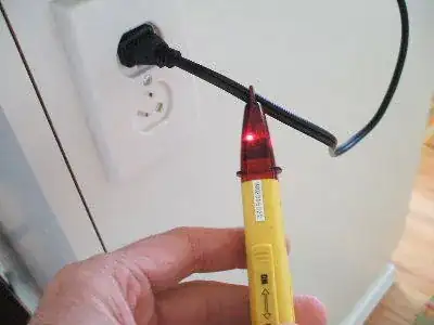

I would swap out the switch and try another light bulb. You should also pick up a simple current tester like this:
This will let you easily test whether the switch input & output, and fixtures are hot, before you do anything.
