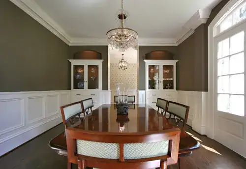

It appears to be just a matter of how you trim it out. You can do something detailed like in the photo or as simple as 1/4 round trim to cover the edge.

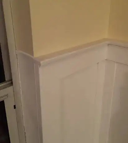

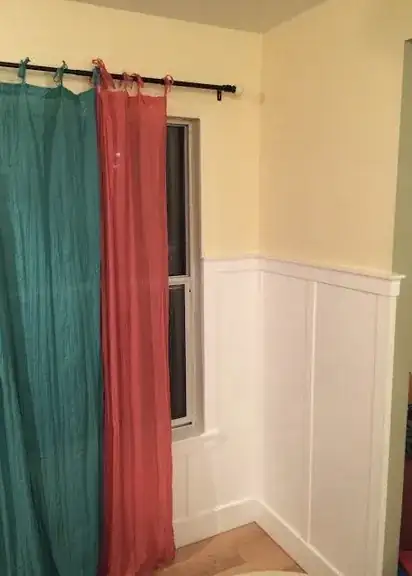

This is a long overdue answer to my own question.
I never did find an example elsewhere of handling this so I just went with my gut and ended up with this:
I pretty much added casing to the outside of the window that met up with the wainscoting and didn't do anything above. I think it would have looked good with full casing as well, but we didn't want to over-due the decorative aspect of this (as you can see it's a fairly plain wainscoting pattern to begin with). We think it looks fine--especially since it's usually covered by curtains anyways (alas, these aren't the prettiest windows to begin with...)
Here's a close-up:
I painted the inside sheetrock white to match the wainscoting and added a little return piece at the division between the white and wall color. You notice it up close if you're looking, but otherwise I think it worked out OK.
