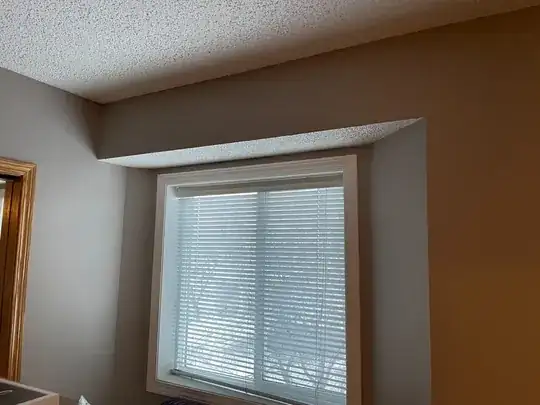

I have this cutout and was wondering how I would be able to hang some curtains without them looking out of place!
I was thinking putting a curtain and rod on the upper part before the cutout but wasn’t sure if there is something that can be done on the inside?

Attach your brackets to the upper window molding as close to the edge as possible.
ojait
  • 11,108
Look into a ceiling mounted curtain rod
Phil Freedenberg
  • 1,084
You might consider "accordion" style folding interior shutters. They would fold up pretty flat against the adjacent walls.
Something like this:
The fact that the opening is asymmetrical would not preclude this from working. And unlike curtains when opened in such a tight space, they wouldn't block much of the window.
