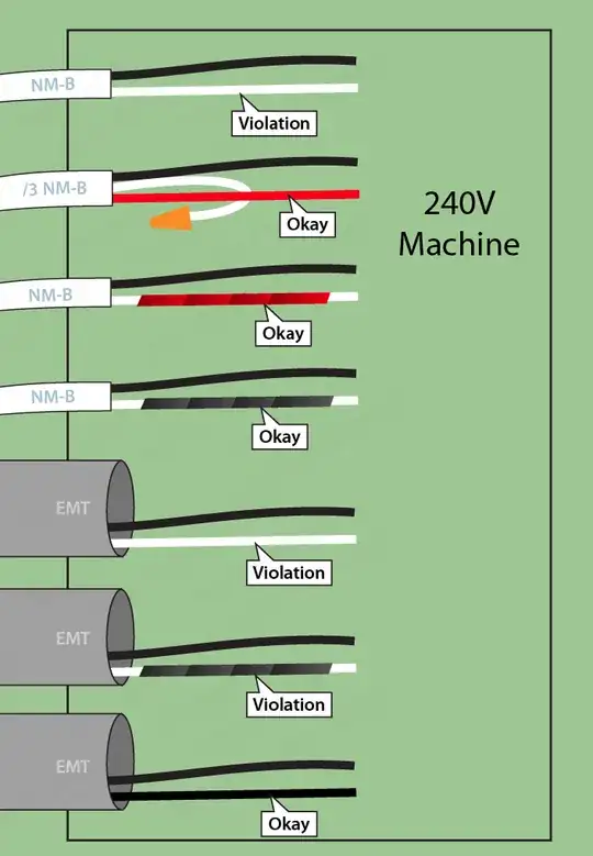

Yeah, I know. Marking wires with electrical tape to indicate function seems like such a needless chore. "I only need to understand it right now. I will never be in here later troubleshooting!" This of course ends up not working 1/4 as well as expected. Some of the people who are marking-hostile write installation instructions.
Since UL approves installation instructions, I'm surprised they don't make the instructions follow Code. Because in this case, Code sides with me.
It is illegal to use white as a hot.
However, if you are buying pre-manufactured cable, what you are allowed to do is use paint, tape, shrink tubing, etc. to re-color a white wire to be an appropriate hot color.
But it's mandatory.
So the most straightforward answer is to take your #8 supply cables, and after you're done stripping off the cable sheath to fit, go ahead and wrap the white wire with red electrical tape.
You can also use black, since there's no particular need with a water heater to match up phases. A 240V circuit with black-black hot wires is perfectly fine.
If it were in conduit, that would be a different deal. Because individual wires are easy to swap, you're required to use the correct color in the first place - no remarking is allowed.
If you're absolutely militant about refusing to mark wires, then my only advice is to use /3+gnd cable (black red white) and just cap off neutral. That would allow you to use one of the cables for a subpanel if the tankless heater doesn't work out.

Except for large wires (not used typically in residential construction past the main panel, except occasionally to connect to a subpanel), hot wires can't be white.
In some conduit installation, the conduit itself provides the ground. In others, a ground wire is required.
Cable
This is what most people are familiar with in US residential construction. Commonly called Romex after a very popular brand name, this includes individual wires inside an outer covering. The colors are standardized. The most common combinations are:
  • 2-wire = Black + White + bare ground
  • 3-wire = Black + Red + White + bare ground
In a perfect world, the colors used would be the same as with the conduit wiring method. However, there are two exceptions generally permitted:
  • Switch Loop - In a switch loop, both wires are hot - one is always hot, one switched hot. In this situation, the convention is to use the white wire as always hot and the black wire as switched hot and mark the white wire with colored tape on each end. But the tape is rarely used, and sometimes falls off, resulting in "why is this white wire hot?"
Note that new switch loops in many locations require neutral, in which case black/red/white, white being neutral, black always hot, red switched hot (though technically it could be red always hot, black switched hot.)
  • 240V circuit - In a 240V circuit (no 120V needed), you only need two wires carrying current (the ground wire is different). Since the standard 2-wire cable only comes in Black/White, code allows using it - with white as a hot wire - for 240V circuits.

You are confusing color with function.
White is not Neutral. White is a color found in cables; the function of the wire can vary, in a cable.
At least in the US Market, /2 cables have black, white and ground (bare or green)
/3 cables have black, white, red and ground.
For a true 240V load (no 120V components) there is no need for neutral. For those loads, a /2 cable with hot white and hot black is the norm. A polite gesture (which I believe is now also required by code, but did not used to be) is to mark the white wire with red or black tape at each end, but "the function is (or should be) obvious."
In a conduit rather than cable situation, white or gray is (or should be) Neutral, since you are free to pull two blacks, or any two hot colors, since wires in conduit are individually supplied as needed - but in cables, you get what's made, and code permits not buying a /3 when you only need a /2, so white can be hot in that case.
In short - beware of assuming that color implies function, since it sometimes does not.
White is a color and on 240 you have no neutral so the white is used as a hot this is code compliant fro 240v only loads if there was 120v in the heater it would require a x-3 with ground wire. Switch loops also allow the hot to be on the white. White is a color and usually used for neutral but not always and almost never marked or reidentified in this case. There are ways if 120 was needed to make it from 240v today switching power supplies are common, in the past transformers were used but most of the time everything in the box is 240v so no neutral is needed.

The white is allowed to be used as a hot in specific conditions such as shown in the diagram they supplied. Here is the code reference that allows it:
NEC 200.7 Use of insulation of a white or gray color...(C) Circuits of 50 volts or more. The use of insulation that is white or gray.. for other than grounded circuit conductor..only ...(1) if part of a cable assembly that has insulation permanently reidentified...where the conductor is visible... If used for...switch loops..shall only for the supply to the switch...
"Grounded circuit conductor" is NEC terminology for the neutral.
You could use a 8/3 cable and use the red as the second hot conductor, and insulate the unused white, but that would increase cost and not add any electrical benefit.
