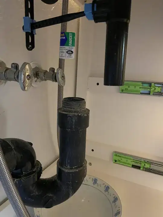

I installed a new vanity and the drain tailpipe does not line up with the P trap. Can I use two 90 degree elbow fittings to make this connect? Can elbows connect to elbows directly or does it require an extender in the middle? See the picture of my problem. enter image description here
The best repair for this problem is to cut the trap from the drain pipe, glue on an ABS 1 1/2 inch (or same pipe diameter as existing pipe) coupling and than a short section of new pipe long enough to bring the trap under the sink tail piece.
You wll have a little bit of leeway because the trap section can pivot from the threaded connection.
