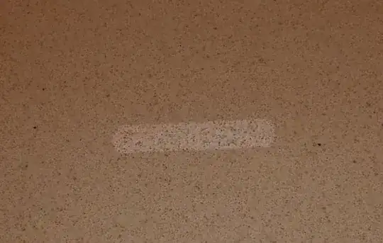

A regular alkaline AA battery apparently leaked on our Caesar-stone (similar to Silestone) island counter top. If this is indeed the case, it has been left there for several weeks. It left a battery sized bleached area. It feels very slightly rougher than the surface around it. In real life it stands out even more than in the picture:
Battery acid damage, dry

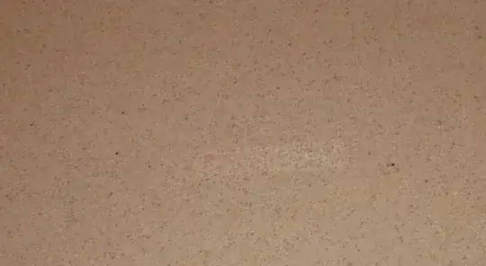

Interesting enough, when that area is wet the mark is much less apparent, almost invisible:
Battery acid damage, wet
Reading on similar damage on-line it would seem that sanding the damaged area will not help, as the acid bleached the color of the quartz. I might try some gentle (800+ grit) sanding to completely smooth the surface, but that probably won't help with the color.
From the observation above (the stain almost disappearing when wet) I hope that a "wet-look" stone sealer might darken the damaged area without touching the non-porous undamaged surface around. Anyone had any experience with something of this sort? I'd really hate to have to replace the entire island counter top.

I would experiment with dye on a cut-off piece. Talk to some installers of Caesar stone or get some samples.
The dye I'm speaking of is a metallic salt type (Transtint) They are intended for wood, but will stain most any material with some porosity to it.
This will be a temporary fix, a surface treatment that will have to be renewed periodically. If you get a mix working (keep track of your formula), you can bottle it for refreshing the color as needed.
I'd suggest 1 OZ of denatured alcohol and 4-6 drops of a Transtint color to start. Mixing is straight forward and color blend is the true genius of this system.
PS wear latex or nitrile gloves..
