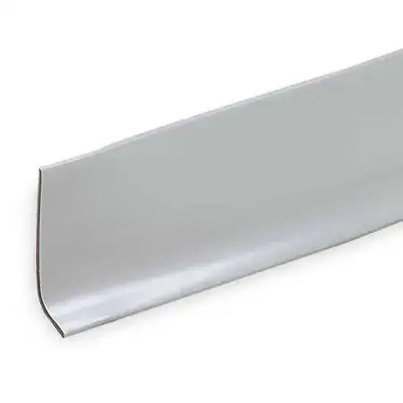

In the bath tub the only joint needing caulk (commonly) is the wall/tub intersection. If your pet only is interested in pulling out caulking you might try repairing the joint with silicone, but than covering it with a plastic wall molding
This is installed with an adhesive. While I wouldn't recommend using this exclusively to repel water it would protect the caulking under it.
]: https://i.sstatic.net/hNtxf.png
