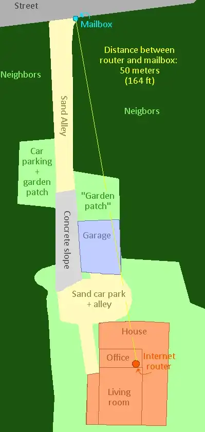

Our house is pretty far away from our mailbox, and we need to walk uphill to go check the mail. The mailman has very variable hours, so we often find ourselves going 3-4 times to the mailbox during the day. My dad is an avid DIYer, and has given himself a challenge: find a way to know when the mailman drops mail in our mailbox. He has thought about a lot of different solutions and none really fit our use case. We looked up online for other people who have done that, but every one seems to use WIFI. Our WIFI unfortunately doesn't reach that far, as the mailbox is quite distant from the house (we measured 50 meters / 164 feet).
He first thought about putting a WIFI camera in the mailbox. However, WIFI doesn't reach that far (the router is in his office, I put it on the diagram).
He also thought about running a cable from the house to the mailbox, attached to a sensor or a camera. However, a part of the path is made out of concrete, and burying the cable would be super hard. He could also run it through the garage, there is a little space between the roof and walls so a cable would probably fit. However, he would then have to drill through the house's walls and having done it in the past, it is a real pain.
He thought about buying a camera or sensor that uses a SIM card to connect to a network that will be picked up by his phone. However, our country forbids the use of SIM cards for communication that is not person-to-person. He would have to get a more expensive kind of card.
He thought about putting a WIFI repeater in the garage, but finds this solution a bit overkill and expensive.
This is a diagram I made of our house configuration using a map:
diagram of our house based on satellite data
We are looking for a solution that is not too expensive and doesn't involve a lot of wall drilling. I have read about people using radio sensors (for instance a tilt sensor on the letterbox door), but knowing nothing about radio waves, we are a bit lost.
What would be an ideal solution to remotely check if the mailman has dropped mail today?

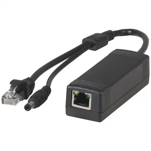

50 metres is well within the range of wired ethernet which when done properly can do 100 metres, and I've pushed it to 120 metres once.
Since your mailbox probably lacks power, you can run a POE injector in the house, which will make -48V DC available at the other end. There are single port injectors, or POE can be done by an ethernet switch with the feature.
At the mailbox, you would have a POE splitter that can produce 5V or 12V or whatever you need to run your device. POE might offer 15W or 30 or 60 depending on what standard you choose, but for me 8 watts is enough to run a Pi4 and a USB HDD.
What you choose to run down there depends on your comfort level. A small computer like a PI allows you to run all sorts of sensors, but you'll have to write code to do things. An IR or ultrasonic motion detector, a simple light beam across the door way, a microswitch on the door, a weight sensor, there are many possibilities.
It may suit you to run several links, even if you only use one to begin with. Digging trenches is no fun, so put in 2 wires as a minimum. I'd contemplate running 4 myself, with an eye to running a POE camera or two for security, one pointing down the road and one back at the house. Direct-burying UTP cable in the soil is a bad idea, you would get much longer life by using ground-rated grease-filled cable, or somewhat-longer life using garden hose. I've managed to pull 2x cat6 wires through a length of cheap home-grade 12mm irrigation tubing, but it was really hard work. Next time I'd use larger tube.
The homeowner can do Ultra low voltage cabling without a permit here, there's generally no need for an electrician.
If I were you, I'd run a fat conduit pipe between the house and the garage, perhaps 50mm, and bury that neatly. Then run the wire through the garage and out to the mailbox in a smaller tube. This will allow you to run other cables between the two buildings easier and tidier, and you can have wired internet access in the garage without attenuation.
