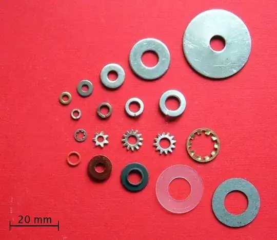

Triple use (as I saw after years of mechanics) :
1) Washers are ofter used to avoid grinding of the support when you screw the nut.
2) Washers avoid the bolt head or the nut to penetrate/damage the support.
3) Washers help things moving in boltened assemblies if you oil them a bit (eg. articulations).
Following Niall C comment : observation and a bit of logic will make you put the washer on the right place, now you know what it can do.
EDIT
There are so many types of washers, i will advice on the more common ones :
enter image description here (image from wikipedia)
Flat washers (first row of the picture) :
  • "Flat not wide" : avoids degradation of the support (paint, ...)
  • "Flat wide" : for pivots, when the pieces you bolt have to move
  • "Flat wide and thick" : for avoiding bolt/nut penetration in not-so-hard supports (pine wood, plastics, ...)
Lock washers (second and third row of the picture) :
  • All types : penetrates the support material in order to lock the bolt/nut and the support
All others types are for specific use...
