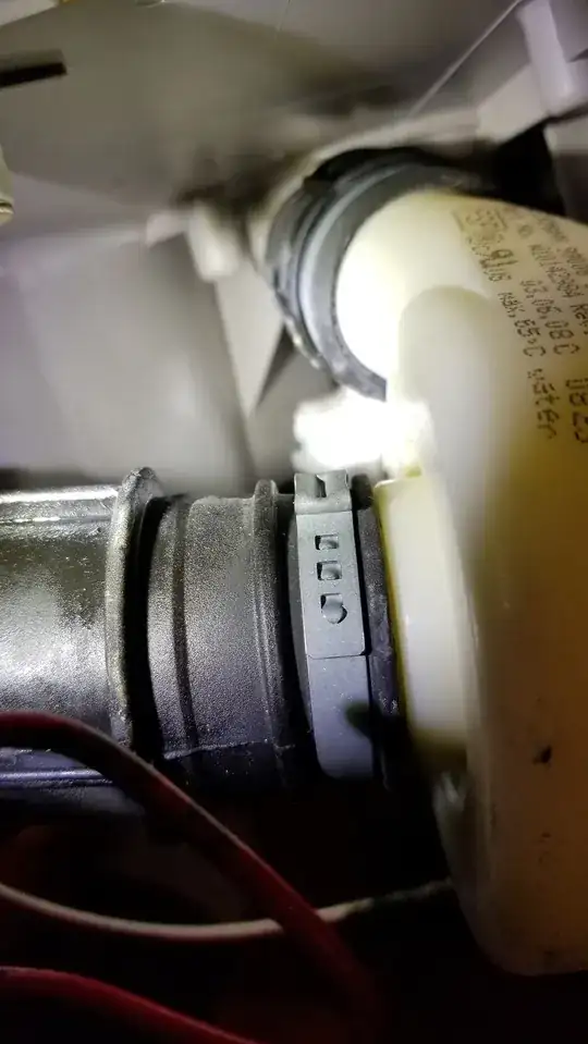

Our washing machine developed a massive leak that caused a flood. We flipped the machine, and traced it back to two holes in a black rubber hose that appears to be attached to the output of the pump. How do I remove the clip that's securing the hose though?
My initial thought was to squeeze it, since it appears that a lip on the front is what's securing it. It doesn't squeeze though, and trying to squeeze it would reduce the diameter, and that doesn't seem possible since it's securing a hard plastic tube which likely won't compress.
I'm wondering if you need to snap the lip off and put a new clip on, then bend the lip down into place?
The clip:

The existing clip has been crimped on with a crimping tool from the factory. To remove the clamp grip the end of the strap just below the notches and lift it up and back. The notches should bend up as you lift. If they don't pry them up with a slotted screwdriver.
replace with a common hose clamp of nominal size.

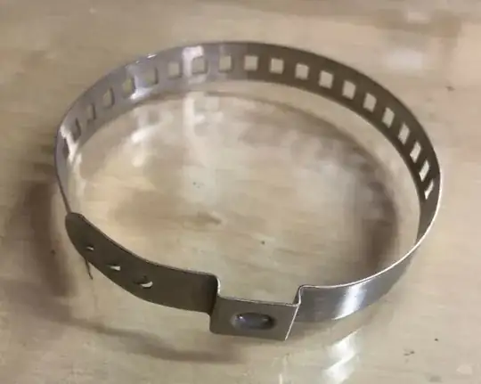

They're called ear clamps, they start out life looking like this:

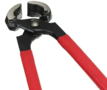

To attach them, the band with the holes is hooked up as tightly as ossible so those "fingers" poke through the holes, and then a tool like this:

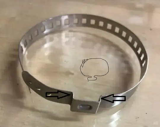

Is used to squeeze the lump in the clip and reduce the circumference, squeezing the clip together. It ends up looking more like the sketched black outline:

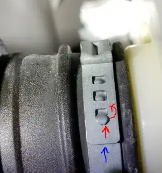

At a push they can be re-used: bend the small "fingers" straight (on your lip it looks like you'll only need to do the longest one; the others don't hook over the band) by pushing a small flat bladed screwdriver in (red arrow actions) and levering upwards, then separate the clip by pushing the screwdriver in between the bands (blue arrow actions) and lever upwards again. Use pliers to pull the clip band up off the fingers:
Once you've got it off you'll need to use pliers to carefully bend the lump back to close to what it looked like as new (so the clip circumference is bigger), but it'll make your life easier to leave the fingers straight.

We managed to contact a family friend. They told us that these aren't reusable and have to be broken to be removed.
We snapped the lip off with pliers to remove it and it came right off.
