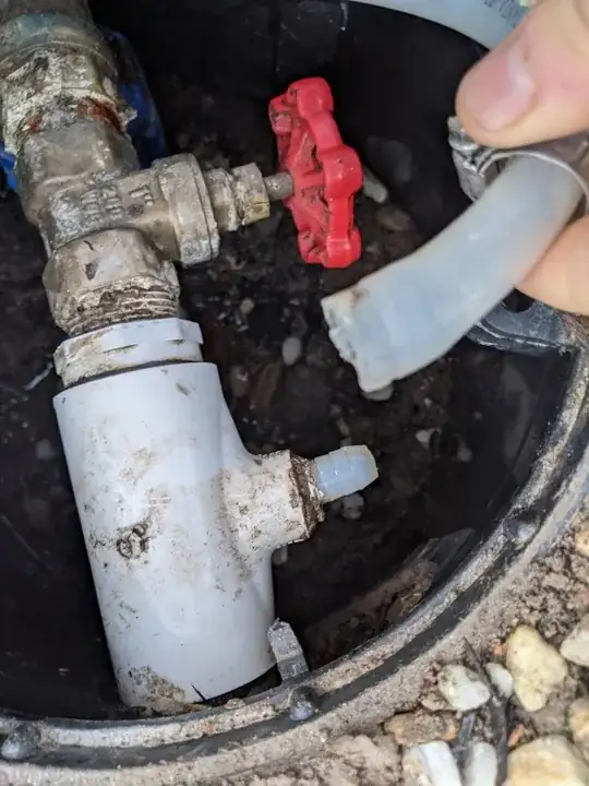

This being an outdoor setup, there is a lot of dirt and debris which, despite my best efforts to keep the system clean, still finds its way into the pump and clogs things. One particularly common choke point seems to be where the outlet of the plastic tubing connects back into the fountain: Outlet of tubing into fountain piping

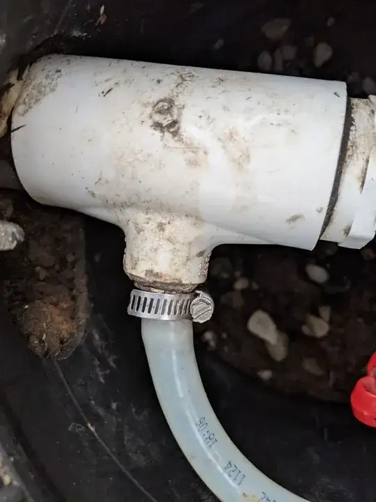

It's currently going in through a barb connector. It is very common for this to be clogged by even very tiny pieces of debris that get through the pump and get stuck at the tiny opening of the barb, reducing flow through the fountain to a trickle. The solution is to briefly disconnect and reconnect the hose, which I am presently having to do almost daily because little pieces of bark from my garden are getting into it. Removing the hose, you can see that the opening the water is going into is quite small:
Inlet of fountain for water
You can also see that the piping after it is quite wide, so there is really no reason the inlet needs to be that small. A better solution would be if I could somehow make the connector male on the tubing or otherwise have a wider opening so this was not a choke point. Any suggestions on how to do that?

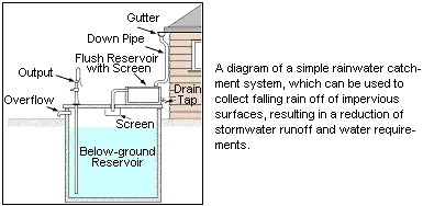

It occurs to me that you could take a page from rainwater collection systems.
Persons wanting to use rainwater from the roof deal with issues similar to yours. . Leaves wash off the roof. Dirt can be in the water.
https://www.dgsapps.dgs.ca.gov/DSA/SustainableSchools/sustainabledesign/water/rainwatercatchmentsystems.html
Adapting this to your fountain: your stream ends with the top of the cistern (like a roof downspout ends with the top of the cistern). You would have a screen over your cistern. The screen would stop things like bark and leaves. The intake for the pump going back to the fountain is not at the bottom, but midway up in the cistern. Heavy stuff falls past the intake pipe and settles on the bottom (where you will periodically clean it out).
Water from the middle of the water column will be free of big stuff that landed on the screen and of small stuff which settled to the bottom.
You could install the cistern and screen in the ground at the bottom of your stream. You could even have it below ground level and have a little pool at the bottom of your stream which would look nice. Or if not, just have the stream end with the screen over the cistern.
I say cistern which implies a tank for holding water but for this purpose a large diameter piece of PVC would be fine since you will not be storing large quantities of water in it.
You can probably buy rain collection stuff off the shelf. You might get by with just buying the screen and then a capped section of large diameter PVC for your "cistern", then the pump you already own.
