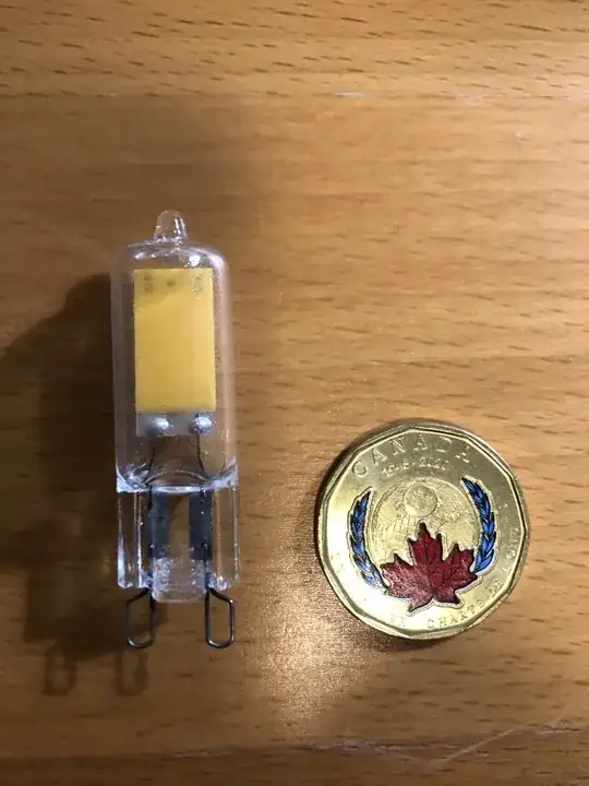

I need to replace a faulty lightbulb but it's not one I've come across before. It's being used in a light fixture in my washroom above the vanity. Can anyone here identify it? I'm hoping I can order one from Amazon or my local Home Depot.
(Loonie for scale)

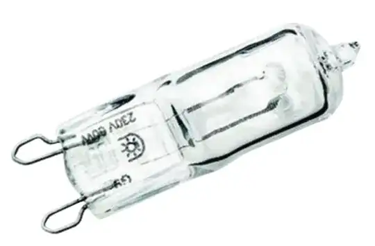

This is a G9 halogen bulb:
Note G9 is the name of the socket and form factor, but it says nothing about wattage. Voltage should be mains.

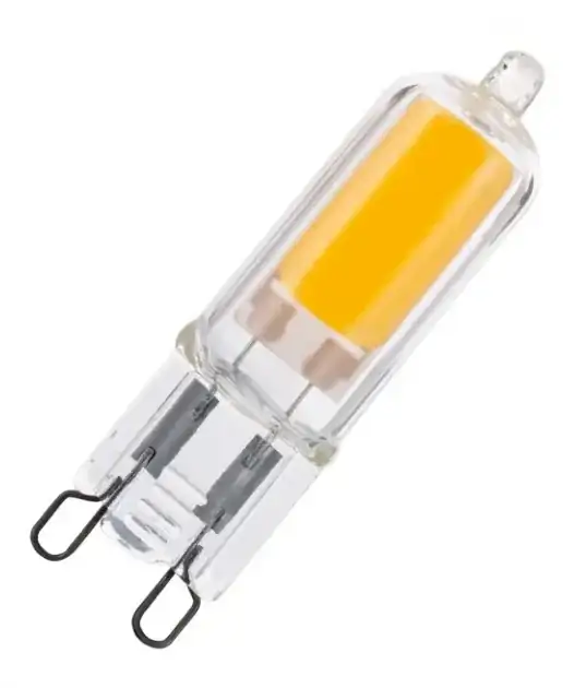

Yours is a G9 COB LED:
Since the original bulb uses LEDs, the fixture may not be designed to handle the heat of halogen, so it's better to replace it with a G9 LED bulb. As for wattage, check the fixture, but really you should be able to use a bit more watts like 5W instead of 2W if you want more light, it shouldn't melt... If you put a 20W halogen lamp in a 2W all-plastic LED-only fixture it will probably melt.

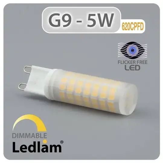

Get a flicker-free bulb if you can, they're easier on the eyes. If you use a dimmer, make sure it says "dimmable". Note the LED bulbs don't all have the standard length, so you might want to measure the space inside the fixture to make sure it fits. For example this one is bigger, so you'd have to check.

It's a "quartz halogen" lamp. You will need the voltage and wattage off of it or the fixture, and that is what's called a "G9 base", which is important to pay attention to because there are several different bases in this style of lamp and that has to match.
