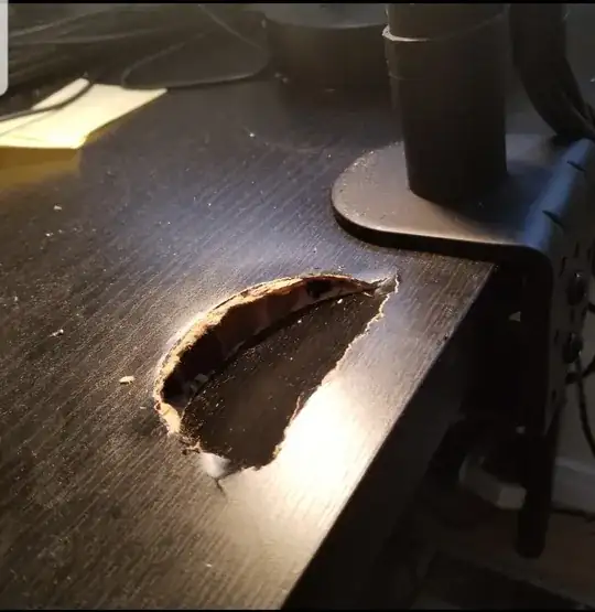

I'm using an IKEA Linmon plywood table 150x75 as a desk and the monitor stand I've been using did this at some point over the weekend.
Looking for a cheap fix to help keep the structure of the table. As it is just my desk doesn't need to be pretty, especially if I could move the stand back over it.

Get a piece of ply bigger than the hole (at least 2 or 3 times the size and use it to spread the load.
If the clamping side is also small then another spreader may be a good idea.

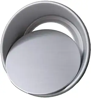

If you want to be slightly decorative you could try something like this...
Start with an aluminum cake pan, maybe 8" diameter (or larger?) With a removable bottom; example:
You only need the bottom.

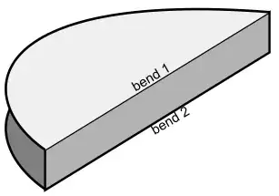

Bend the circular bottom twice with e.g., a vice, or using clamps & a block of wood (*), so that it carefully will slide over the thickness of the table top, and look like this:
Spray paint it black.
Slide this over the hole.
Clamp the monitor to it.
Now it will reinforce the hole and may actually look good or even like it is part of the monitor stand.
Being thin metal it won't get in the way of other objects.
(*) a metal 'brake' would be ideal

I know its not a fix as such, but its probably not worth going out your way to fix this issue, The desk in question is very cheap and a new top can be purchased for as a little as £6.
https://www.ikea.com/gb/en/p/linnmon-table-top-white-00251135/
Despite being honeycomb particleboard these tops are suprisingly strong so im suprised your mount managed to make such a hole. I also have a monitor mounts with 2 monitors on it on this top and its held up fine for over 3 years now.

Enlarge your hole to a minimal rectangle with square corners that meets the edge of the desk's frame. Cut a block of wood to match the indicated hole. Glue it to the wood frame (marked in green), and to the (interior) bottom of the desk if it's smooth enough. Run screws as indicated in the picture, so that they pierce through the wood frame and the block. Pre-drill holes if possible. After the glue dries, use the monitor mount clamp over the repaired section to avoid making another hole.
If there is no identifiable wood frame, don't attempt this.
Many hardware stores that will cut lumber for you will also sell partial pieces at a steep discount (or free).

Based on "Cheap Fix", I would obtain three pieces of timber:
  1. piece exactly as thick as the desk, which will go inside where the cardboard is. Size should be at least 2 inches square, but not so big you can't get it in the D-shaped hole. This will act as packing and will not be visible.
  2. short planks of pine or customwood or plywood. The top one will be seen, so its up to you if you want to stain or paint it. Thickness should be 1/2" to 3/4" (12-18mm) with a depth of 3" to 6" (150mm to 300mm) and a length of 12" or 300mm.
Pop the lid up so you can access inside the hole. Clean out the cardboard packing that is in the way.
Fit the packing piece inside the D, and lower the "lid" You might choose to glue it down with wood glue, and to the back frame if possible. Clamp while glue dries.
Put one board across the top and one underneath. Use your monitor clamp to hold both together. You should be able to crank down on the winder underneath because the compression is squashing on your packing piece in the middle.
Right now you're at risk from your monitor stand doing the same further along the desk.
Also, having the monitor arms stretching toward you will also increase the pressure on the desk.
Your other somewhat-cheap option is to put a new board on top of the entire desk surface. 18-25mm customwood is cheap.
Heck if you find a nice top, you could simply move the legs over from your existing desk, and have something that isn't made of cardboard.
Aside - never stand on this desk, if it can't take a monitor it can't hold a person.
