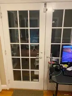

This is an overview photo of the door. Both doors have latch pins extending upward and downward into the door frame. These are extended and retracted by the latch mechanism and this is what is failing:
Photo of door

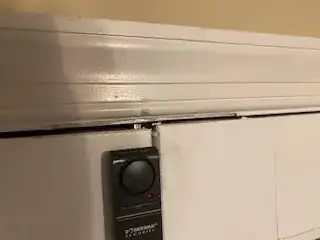

This shows the latch pin extending upward into the door frame.
Photo of latch pin extending upward into the door frame

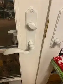

This is the main latch mechanism. Not much to see here. Anything more interesting is on the edge of the door, which is what I cannot get to.
Photo of main latch mechanism

I had a similar problem with a Sierra Pacific door. On mine you raise the handle (clockwise) to lock and lower the handle (counter clockwise) to unlock.
I lowered the handle as far as it would go and then with a small screw driver pry the pins up / down to fully retract the locking mechanism. That would be your pin in picture #2 and the one that goes into the floor.
I was not able to find a replacement that would fit, but was able to fix the broken piece.
