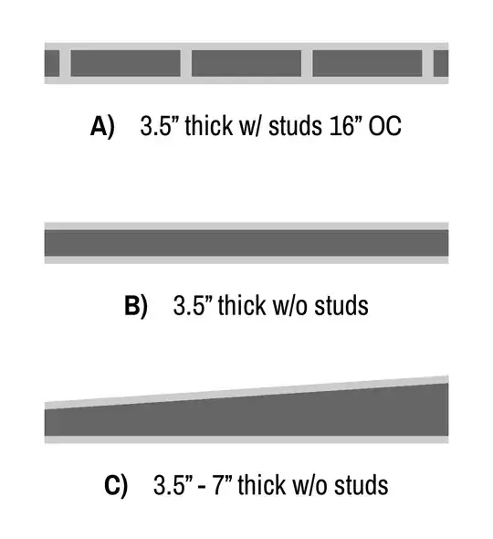

As a more concrete example, the illustration below depicts top-down views of wall cross sections, where light gray represents 2x4 studs (vertical) and sheathing (horizontal) and dark gray represents insulation fill. My understanding is that examples A and B would be rated equally at R-13. At what R-value would a wall like example C be rated?

All calculations are based on the sum of the R - values in any particular component, (i.e.: walls, roof, etc.) To answer your question: when the component varies in thickness, then the AVERAGE of the R - value for any given AREA (given in square footage) is used.
The Energy Code gives allowable “Prescriptive Paths” that meet the Energy Code criteria for walls, slabs, skylights, HVAC, windows, roofs, etc. If for any reason your construction does NOT meet the “Prescriptive Path” for any component, then you can substitute a higher rating for another component...provided it meets or exceeds the rating and area. (It gets a little tricky substituting a higher rated HVAC unit for using more windows than what’s allowed by the prescriptive path, but there is a formula based on your heating / cooling degree days.)
There are energy calculators you can download, which are suitable for your area (zone). You can stipulate if the studs are 16” oc or 24” oc,I don’t think you can automatically do “no studs”, but you could add the R - values up longhand. I’d call your local Building Official to get the name of such a software program. (Even I can use the program and I have trouble adding 2 + 2)
