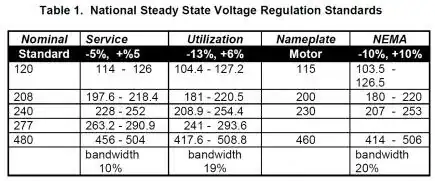

That is well within ANSI C84.1 North American Utlity Standards.

240 V is the "nominal" reading. You'll usually get ±10% voltage from the utility lines, and your appliances are designed to accommodate that variation.

You will be fine with that. The power company usually delivers 5% +or - the normal 120/240 residential voltage. Your meter also has a tolerance of up to 3%.
