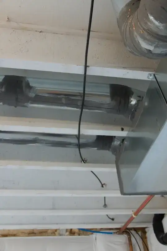

I'm in the process of finishing my basement and, aside from a ground wire that was run under the floor joists, I have a fairly clear path for drywalling the ceiling along the floor joists. I have contacted the builder and they are refusing to address the issue. I've done some research on the subject and I've found other answers on this site pertaining to NEC codes for hanging wire to floor joists, but I believe the code doesn't specifically address my situation because the ground wire is a single 2 AWG conductor, while the NEC code (from the sections I've read) specifically call out two 6 AWG and three 8 AWG conductors. I've tried to find any additional information on this subject, which might be directly relevant to my case, but I haven't been able to locate anything. Is there a specific section of the NEC that addresses this case? Is a single conductor 2 AWG run under the floor joists up to code? If this is to code, how would you recommend I hang the drywall?
As a side note, I am not a contractor and I'm essentially trying to learn framing and drywalling by watching YouTube videos, so it's not that I'm trying to be a pain, but having the cable run through the joists (rather than under) would make my life significantly easier.

Edit: Added image
Joists with ground wire

Your #2 wire is large enough to be run without protection or a backer if running perpendicular to the joists in the basement ceiling. 250.64.B.3 requires wires smaller than #6 to be protected. The basement ceiling is considered a safe location and the specific height is not given. 334.15 provides the examples of attachment as you have mentioned. I would caution that some older code answers are not current code as code has had significant changes in the last few cycles. (Each cycle is normally 3 years).
