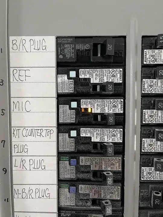

I have a brand new Bosch Microwave (model: hmd8451uc) installed as the only device on the entire circuit. Anytime I use the Microwave on this circuit, it triggers the breaker's ARC Fault. Breaker (Murray MP-GAT2 20AMP).
I bought one of these guys (https://www.amazon.com/dp/B07PMDRHXB) and pushed it into the socket where the microwave is plugged in, and everything passed. I was also able to test the ARC Fault mechanism, which seemed to work just fine.

Edit: image of breaker:
Breaker Image

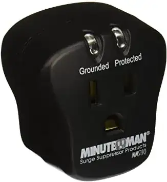

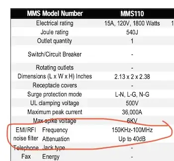

Install an EMI/RFI filter between your appliance and the socket
This solution is the cheapest and fastest solution, and doesn't require an electrician to come out. The only downside is you need about an inch of space between your appliance and the outlet, which may not always be possible with all appliance like washer/dryers.
It works by sending all the noise (sine waves) that the appliance generates into the ground wire. The one that Siemen Tech recommended was:
Minuteman MMS110 Surge Protector
MMS 110 MMS 110 description
I've tried this and it works well so far haven't had any breaker trips.

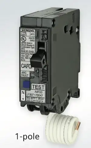

Update the circuit breaker
The Siemen tech mentioned that each AFCI breaker has a specification that it needs to function by, so there is no warranty coverage applicable here. The breaker is functioning to its manufacturing specs. And they are constantly releasing updated version.
My breaker version is 2b. The versions go 2b, 3a, 3b, and 3c. Each version has been updated with new sine wave detection algorithms to work with more appliances, having less false positives.
And when you purchase from amazon you won't know version version you are getting. So you'd need to go to like Home Depot and see the breaker in person, here is how to identify which version you have (which is not documented anywhere lol):
  • 2b - No label - 2018 and Pre 2018 era
  • 3a - 2 Green Vertical Bars with Black Line between bars.  2019 era
  • 3b - White label with Black letter N and Down Arrow.  2019/2020 era
  • 3c - Black label with White letter N and Down Arrow.  2020/2021 era
Here is version 3b, see if you can identify the version with the above info:
Siemen Version 3b

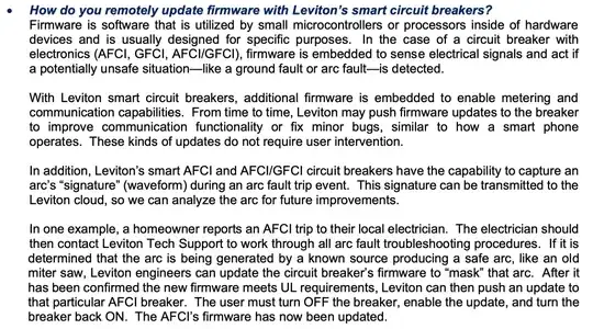

Get a Leviton Smart Load Center
This is probably the most expensive thing to do, have an electrician come out and replace your entire Load Center. But there are some long term benefits to this solution! (I'll probably do this in a couple more months)
I just spoke with a Leviton Smart Load Center engineer. I put a request in on there website to ask if their Leviton Smart Load Centers would be affected by my Microwave. And somehow my request went to a Leviton engineer, so I had a chat with him about this issue.
He stated that they didn't know about my exact microwave, but something interesting is that Leviton Smart Load Center is able to receive firmware updates to address new false positives for AFCI breakers. And that they are continuously monitoring for all false positives within all homes that have the Smart Load Centers. This allows them to continuously push firmware updated into their breakers without any intervention from the customer. So you get the latest version without having to replace the breaker! Now that sounds like a pretty neat solution to this AFCI nonsense!
After seeing the conversation between Peter and Nate in the comments for whose responsible for these issues (the appliance manufacturer or the AFCI Specs)... It's kind of refreshing that Leviton solution does work long term and is customer friendly. Siemens approach was to buy a 3rd party filter and if that doesn't work, to upgrade your breaker.. I still can't get over how they expect you to continuously buy an upgrade breaker to have the latest firmware for sine wave detection. At least with Leviton, that is done automatically since the breakers are connected to WiFi. Another benefits with Leviton is it's able to detect the difference with a series and parallel arc fault. And you can monitor your electricity for each circuit.
Leviton SLC description here Leviton Smart Load Center
