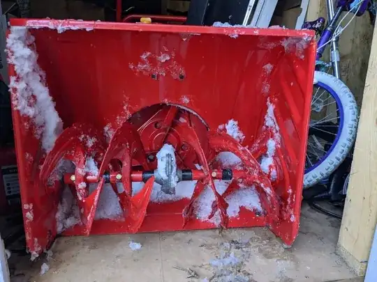

One side of my snow-blower got caught in a rope and snapped both shear pins (for that side).
I found two spare pins that came with it and installed them.
But when I turned the machine back on the blades on that side started hitting the side of the machine. I'm afraid to use it in this state I think I might break it more. Is there an easy way to fix this?enter image description here
Now that I'm looking at this picture I can see that the blade is bent. What can I use to bend it back?

I have had good luck using a crescent wrench when needing to bend “thin metal” close the jaws tight then the cresent wrench gives some leverage. The larger the wrench the more leverage large water pipe adjustable pliers would be another tool I would use
