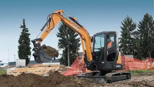

I plan to rent an excavator like this:
mini excavator
I am aware that it is quite dangerous if someone walks by and is hit by the bucket, but assuming I can clear the area of passers-by, what are some common dangers to be aware of that could cause harm to the driver? Can a mis-move of the levers cause the bucket to break through the cage?
No, and that is a fundamental design regulation of the equipment you are planning to operate.

Something touched on by the other posts is tipping. If you'll note, the excavator you intend to rent has treads that are no wider than the cab. There's two reasons for this
  1. Weight. You want this thing to be light enough to fit on a double-axle trailer and be towed by a decently powered truck or van. This is weekend-warrior stuff and a lot of rental places will happily load one onto a trailer for you and send you on your merry way
  2. Size. It needs to fit on said standard trailer without sticking out (street legal reasons)
The catch there is it makes the cab really REALLY prone to tipping because you have nothing to offset the weight and the treads are close to the center of gravity.
