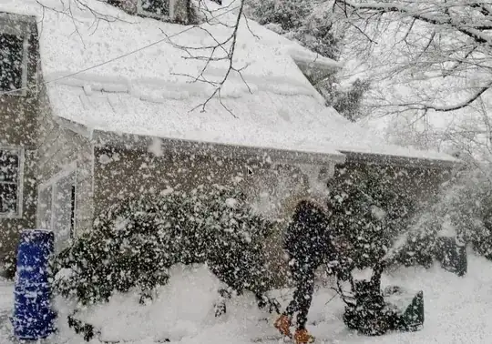

As others have said, whether to rake or not depends on your circumstances.
See the picture: I have a steep poorly insulated roof over my home that extends out over an unheated garage and becomes more shallow there. Snow melts on the steep part and water flows down under the snow to the unheated shallower roof where it refreezes and forms a dam anywhere on that part of the roof depending on the depth, weather, rate of melt and so on. So I rake the flatter part of the roof over the garage as you can see. This allows the sun to do the work and keep the water from the warmer part of the house flowing.
I would probably rake higher but that's as far as I can reach with my 24 foot rake.
You should consider the slope, depth, current and forecast temperature, amount of sun, etc in deciding.
