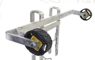

Most ladder accidents are not a result of leaning back until it tips, or indeed the footing slipping away, but from over-reaching & sending the ladder sliding or even spinning sideways.
The simplest, safest way to prevent ladder slippage & mitigate for over-reach is to attach wheels… to the top.
This means the force on the ladder is closer to vertical. The wheels allow for the full weight to press into the ground, reducing ground slip & are less prone to sideways slip at the top.
You can get these either in-line or attached to a wider stand-off, which is even more stable.
You still have to contend with your potentially slippery ground surface in this case. I would dig a 6" mini trench to park the feet in. Avoid the concrete apron in icy weather.
