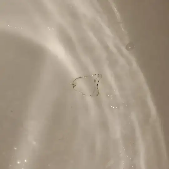

I accidentally damaged my tub, the color is still there but the finish or outer layer shell is missing.
Any ideas how I can repair this without making it look worse?

IMHO, IME, you're going to have to replace the tub to get a truly acceptable fix.
Your description of the material suggests acrylic over fiberglass, or at least that's the most common sort of "plastic" tub these days.
There are various products that can be used to attempt repair. They are probably better than doing nothing, but the odds of getting a repair that looks "like it never happened" are, in my experience, very low.
The primary difficulties are precise color matching and getting the finish of the repair to match & blend with the finish of the rest of the tub. Bonding can also be an issue, but that's generally less of a problem (assuming reasonable attention to detail.)
