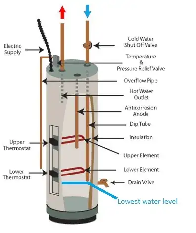

It should not be possible to fully drain your water tank unless you use the drain valve and tilt the unit. The lowest the water can go is the bottom of the cold water pipe. Notice the blue line I added to the image.
However if your heater is still heating then it could evaporate all of the water and cause premature death for your water heater. Notice both heating elements are above the minimum water line so you don't even need to drain all the water to kill your heating elements.
