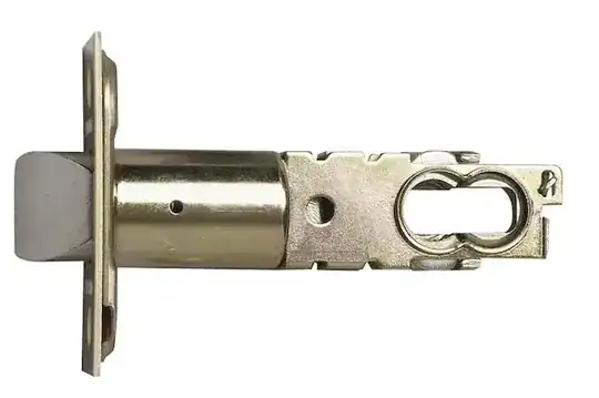

Depicted below is someone else's photo of the exact lock/latch mechanism I'm dealing with.
Latch mechanism

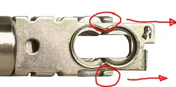

Turning the latch mechanism can work, but you need a shaft that closely fits the circular shape around the opening.
Instead, just slide one of the little ears with tools or fingers to retract the bolt:
If you can see the bolt in the image, just insert a flathead screwdriver and turn! Borrow one from your neighbor or local repair shop. They'll take pity on you.
How to tell if it's locked? For electronic ones with the faceplate on, you can't. The only way is from the inside or by checking the app that allows you to control it. If the faceplate is off it's obvious. All these locks are about the same. You don't need to even know since you can test the door lock by trying to open the door.
If you're saying that the electronic keypad is between you and the bolt and you can't even see the inside then getting it open is going to involve a.) taking the door out of the frame (if the bolts are on your side) or b.) destroying the faceplate or door.
