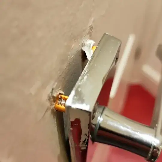

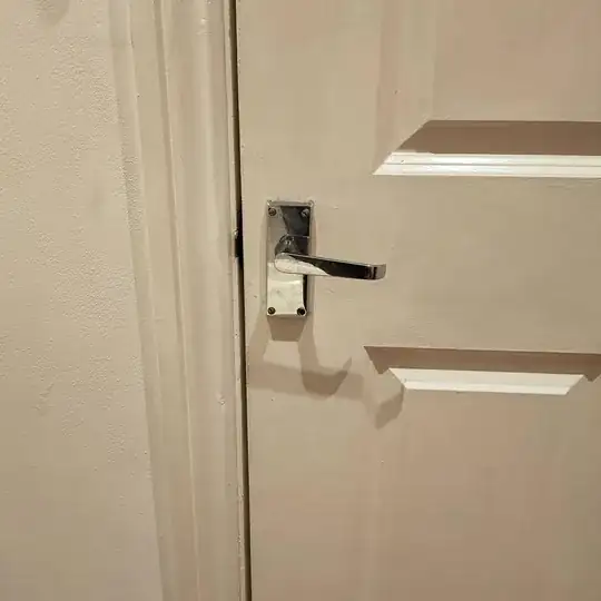

I have a hollow core interior door. The screws for the handle keep pulling out. To fix this I've used the biggest screws that will fit. I've tried a couple of different types of glue, and I've tried hollow door plugs. All of these solutions last a little bit and then the handle starts to pull out again which is a royal pain.
The other side of the door looks the same, except in reverse of course. Both sides are screwed in using wood screws.
I can buy a different size and shape of handle which will use different holes, but I suspect I'd just wind up with the same issue, i.e. the screws pulling out and then I'm back to square one. I'd rather find a permanent solution to the problem.
What are my options for keeping my door handle on?

From a wider perspective: enter image description here

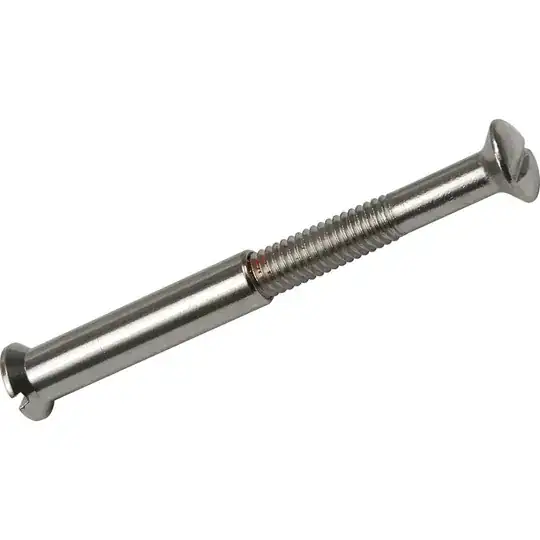

In the Netherlands (and other parts of Europe) we use a 'patentbout' for this situation.
pantentbout The holes are through the entire door and line up with the shields.
refro

Second, have you tried the type of drywall anchor that pull toward the wall as you insert the screw? Your image looks like the ones that expand away from the screw which won't work as well here.
Most of these are made for drywall thickness but you can probably find some that would do the thin wall of your door.

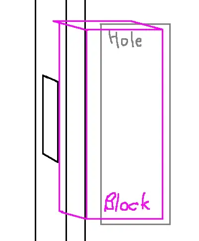

This answer assumes your door is hollow.
Firstly, inspect the hinge side of the door. Tap it to see how thick the hinge style is - if the door is not worth fixing then don't. One option is to replace the door completely, but that's expensive and its hard to find a door that matches your others.
If you think the door is best repaired, then fill it.
  1. Remove lockset and handles.
  2. Cut a hole through the inside skin of the door, perhaps 75mm wide and 100mm high. Leave the lock style (ie the edge-wood) intact.
  3. Pull out any cardboard fill that is in the way.
  4. Cut a block of wood to the thickness of the gap in the door. It should fit between the two layers of cladding/facing and it should be large enough to hold the lockset.
  5. Use construction adhesive to fit the block inside the hole. Also use long wood screws through the lock style to hold it securely while the adhesives set.
Next day, install the lock
  1. Drill a pocket in the side of the block to accept the lockset.
  2. Drill cross holes through the block for the doorset's activation lever.
    Essentially you're installing the lock from new, almost.
  3. Cut a filler patch of thin wood such that it fills the gap between the block and the surface of the door. If you want to be fancy, you could colour-match it and make the edges all perfect. I would not bother - I'd glue it down but then I'd cut a second board and mount it to the face, such that it covers completely the filler board. This last board should be straight with chamfers and a good visual match.
  4. Lastly, fit the handles. You can use the through-bolts mentioned in other answers, or you could use normal screws into the initial block.
