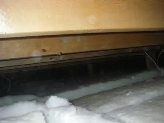

The hole I cut is right next to the brick wall, in the far corner:

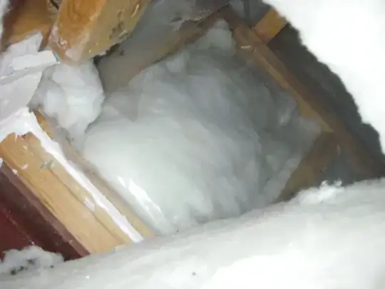

Looking up into the hole, opposite the bricks.

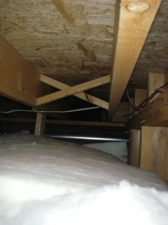

In the above picture (looking towards the back of the garage) you can see a heating vent that runs across. There are two vents in the front of this room (next to the brick wall from the first picture), and more vents that run through the ducts themselves. Presumably I'll have to build a bulkhead at the back of the garage for this, but the rest of the ceiling can still be raised.
The electrical you can see is for two lights and a plug on the ceiling for the garage door opener -- all easily moved.
