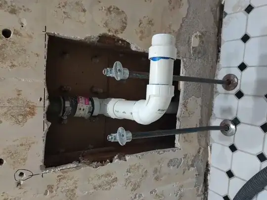

Renovating a bathroom in our 1940's house. Removed the current vanity and found this
enter image description here I'm eventually tiling over this wall with 3x6 subway tiles. Any suggestions on how to obtain a surface I can adhere some tiles to reduce the size of the opening?

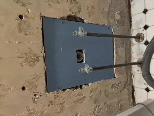

Many thanks...current status

I'd just remove the plaster the rest of the way in the area of interest and replace it with backerboard / cementboard.
Tile is expensive in both materials cost and labor.
Putting tile on a dubious substrate is, therefore, a poor choice. If the substrate fails, your expense in both money & time invested is lost. The slight additional money and labor to provide high quality substrate for tile is well worth it.
You could do any standard large-hole drywall patching technique if you would rather. I would not advise that, and I would not advise tiling the wall (beyond the hole) as it stands, based on these pictures. You might get away with it. You might not.
