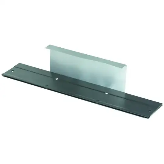

I second Nate's comment that folding the edges is your best bet - it'll give you a small, slightly rounded edge, instead of a sharp edge, and it will stiffen your panel. The drawback is that you probably need a sheet-metal brake to make this happen in anything resembling a neat, time efficient fashion, especially for 200 copies.
This is a small portable brake, bigger counter top & freestanding models are also available:
Image courtesy of HarborFreight.com. No endorsement implied. However, for your one-time use, this one may be right up your alley, so the endorsement is, basically, intended.

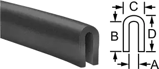

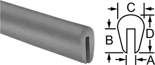

Two thoughts
First - "edge molding" or "rubber trim" comes in a variety of sizes, types, hardness, shapes, and prices. Here are just two examples taken from many from one of many vendors - not a recommendation
