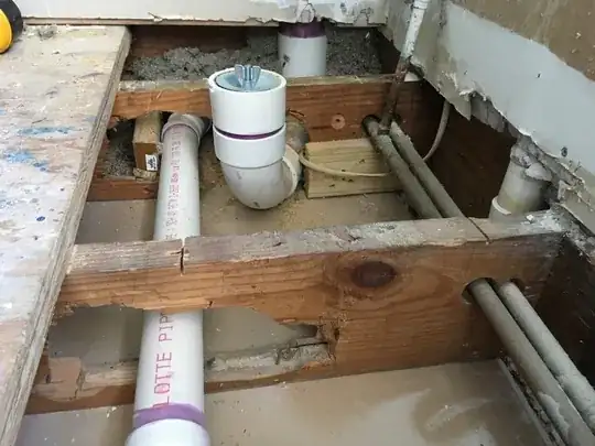

After removing the sub floor in my bathroom in order to extend the sewer pipe for the toilet (it's too close to the tank-side wall), I found that the floor joists have extremely large holes cut in them to make way for the plumbing.
What are my options for reinforcing them? I don't think I could do a sister joist both because of the plumbing running through the joist and because the joist runs quite a ways through the floor of my second story, and adding a sister joist would involve taking up a ton of the floor.
Should I brace it with steel bridging? I'm concerned about the potential vertical load.
What options do I have?
The room is approx 74" by 105" (the 105" runs in the same direction as the joists, it appears that the joists are at least that long, but may extend beneath other rooms) Joists are 15/8 inches wide, 71/2 inches tall. There is a 1st floor bathroom below. There is a tub in the 1st floor bathroom bordered by 3 walls - one of these walls runs perpendicular to the joists 4 feet away from the wall shown on the right in the first picture below.
holes in joists

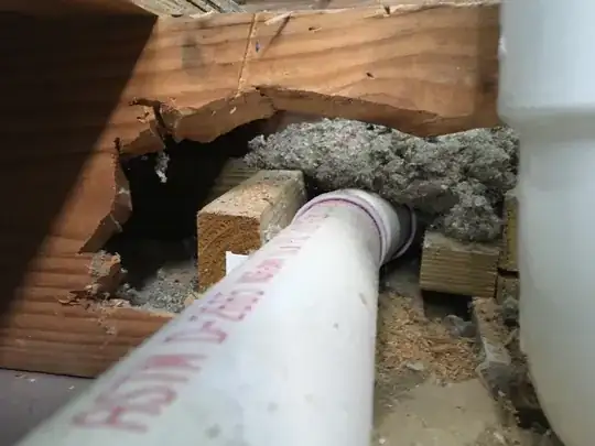

You can see in this close-up that the furthest joist is completely missing it's bottom: close up of hole in furthest joist

The toilet rough in appears to have completely cut through the joist so there is no connection and it has been blocked to the side joist with a single 2x4 and a single nail.
You likely want to get a structural engineer to specify a prescriptive fix for this. A site visit and prescription is likely to cost less than $1,000 and be well worth it.
You might be able to sister with steel that is shallow and could sit above and below the plumbing penetrations and not need to be sistered the full length of the joist.

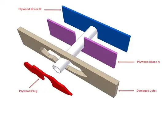

I would sister 2 pieces 3/4" marine grade Plywood Braces (since it's under a toilet) on one side of the damaged joist as shown below. Use Epoxy or Urthane glue and SS deck screws to tie them to the Damaged Joist. After both Sister Braces are set and in place, add a plug (not shown) in the gap of the Brace A's (purple) opening since it'll be under compression.enter image description here
Then trace the joist's opening and make a rough cut plug. Glue this in and fill in the gaps between the plug and the joist with a "filler type" resin.
Finally add 2 more Sister Braces (not shown) like on the first side.

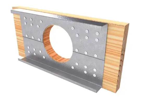

1) Sister using steel C channel:
Sistering the joist with some C shaped steel channel with an appropriate round (not rectangular! see below) hole cut through it. You'll have to break and re-make the plastic pipe to do this, but that's relativrly easy - PVC cement.
The idea is that C channel will lie with its back (the web) flat to the joist, so it can be very well secured to it, and torque (twisting) won't be a point of weakness.
The C channel wouldn't have to be very thick. It needs a stiffness more than or equal to the joist's original strength for safety and wood is very limited stiffness compared even to thin structural steel.
Theory:
In steel constriction, be it "I" beams (RSJ), C shaped channel, or rectangular tube (RHS), the strength is provided by the flanges (the top and bottom parralel surfaces) not so much by the web (the connecting part between them).
The idea is that as the beam takes on its load, it flexes, and the flexing means that the 2 parallel surfaces have to stretch at different rates. The thicker the top and bottom flanges, and further apart they are, the stiffer the beam.
Steel takes a lot of force to stretch, so it resists the load well. But this also means that provided the hole is of a size that the channel keeps its shape (which this looks like it will do) the web is very much secondary - which is why I suspect a hole even of this size won't matter to it,provided the steel is firmly fixed to the joist along its length and top and bottom.
In fact, the web's main job isn't to resist load. It's to keep the 2 parallel surfaces aligned and separated in their original position so they would have to stretch under load (thus resist it), and can't just move closer or twist instead.
Note as Jasen says in comments that its important to cut rounded not crude/rectangular holes, to minimise stress and weakness in the steel, which naturally arise much more at cut and sharp corners.

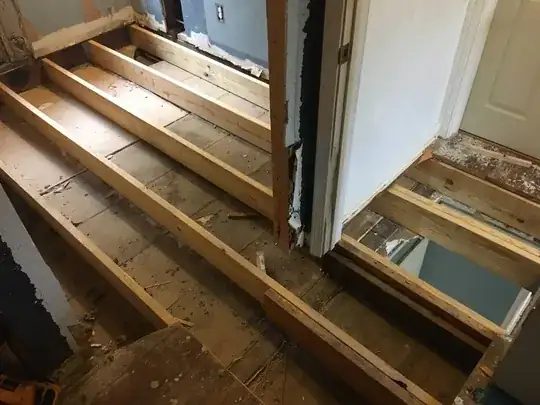

Well, it's almost a year later so I'll fill you all in about how I fixed it. The city inspector insisted that I couldn't sister the joists or repair the hole. I ended up taking up the rest of the floor and replacing all of the joists in that room. It ended up expanding the job into the adjacent bedroom and the landing at the top of the stairs. I had to take out part of the ceiling in the room below the landing in order to get the joists under the wall (as seen in the photo).
It was a hell of a job, but it's safe, sturdy and to code; and I learned a lot doing it. I finished the whole renovation about a month ago and the bathroom looks great now.
Big thanks to everyone for the advice, which was a huge help in getting me started learning about possible solutions :)
Photo of the replaced joists
