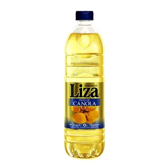

I have just acquired a small battery powered chainsaw (Makita DUC245), and would like to use an eco-friendly and skin-friendly chain oil if possible.
Lots of sources suggest the possibility of using vegetable-based oils, and I would like to do so.
I have one doubt though: should I use a chain-and-bar specific product that is based on vegetable oils (probably with additives), or can I use the regular, edible canola oil that is sold in supermarkets?
I appreciate both practical experiences as well as technical references.
Update: I live in subtropical climate that almost never goes below water-freezing temperatures.
