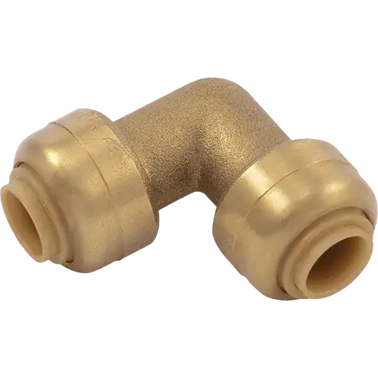

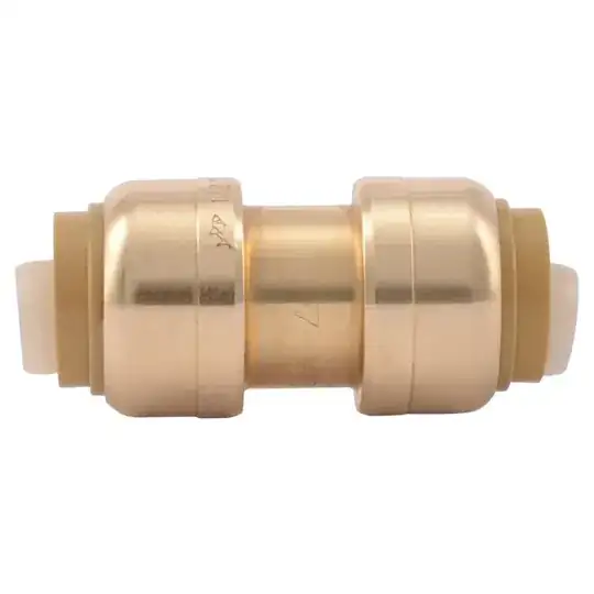

Alternative #1
For the DIYer... just add a sharkbite connector that you need like the ones below. They install with a dribble just fine.
Alternative #2
If you are hiring a plumber they are removing that section, adding a connector on each end new copper in the middle. I do not let plumbers sodder pinhole or bad connections on my lines.
