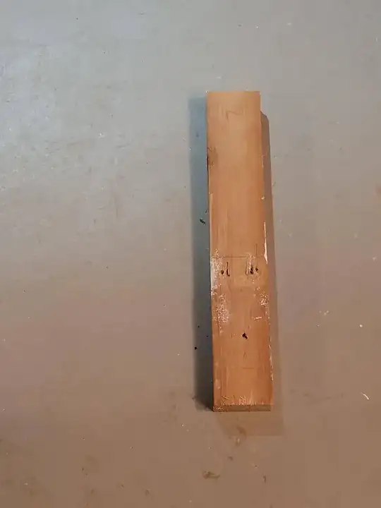

As I've gutted some of the parts of my house, I've found nothing but really nice, straight, clean 2x3"s. Luckily I kept them and was able to reuse them in various places. Here is a picture of a small piece:
As you can see, the edges are nice and crisp, and I can assure you that the longer stud that this piece came from is straight. It seems like maybe these were milled better than nowadays. My house was built in 1954.
So my question is, do they still produce 2x3" studs that are straight? I don't mind paying more for a good product. And I guess if I have to I'll drive further too. FWIW I'm in Maryland.

I've worked through hundreds of units of framing lumber over the last 30 years, and the difference between big box lumber and "lumber yard" lumber is insubstantial, on average*. In fact, it's often better from big boxes due to higher customer expectations. The local HD's competition were actually forced to raise their lumber quality to compete on that front. The reputation at Home Depot, for example, mostly comes from folks walking in to buy their first 2x4 and not recognizing that this is a natural product with natural variation.
The simple fact is that two things primarily affect lumber quality, aside from grade (and most stores sell more or less the same grade):
  • Age of the trees. We consume so much lumber these days that most of it is "new growth", planted (naturally or artificially) 20-30 years ago specifically for lumber harvest. This means wider grain and softer wood, which can warp more.
  • Storage practices and sales trends. If lumber isn't kept dry and sold quickly it'll warp. 2x3s in particular don't sell nearly as quickly as 2x4s, so they're sitting in a store drying out and warping longer. They also tend to be used by finicky homeowners who don't know how to use them correctly more often, so the slightly bowed ones are left behind to accumulate and become severely bowed. You can see how this skews perception.
Yes, modern lumber is softer and may warp more. No, it's not really a problem with a few techniques:
  • Sight down one corner lengthwise to properly assess straightness. Don't be too picky. Shoot for < 1/4" of bow in 8'. Reject severe twists, though, as you can't really work that out during installation. "Fifth-sided" boards with a little bark on one corner aren't usually a problem if they're straight.
  • Use bowed boards where you can straighten them, such as in wall plates that are anchored at close intervals.
  • Crown your studs to put all the slight edgewise bows to the same direction. This reduces waviness at the center of the wall's height.
  • Use badly bowed or twisted boards for drywall backing and other places where they can be cut to shorter lengths.
  • Take care of your lumber. Store it under cover and use it or weigh it down soon after purchase. Lumber that's exposed to very wet or dry conditions will warp whether it's bundled or not.
The bottom line is that, unless you're building furniture, the hassle of buying a few boards through a lumber yard's process or special ordering boards isn't likely worth it.
* I'm in Minnesota. Could be that we get better (mostly Canadian) lumber than in other regions.
