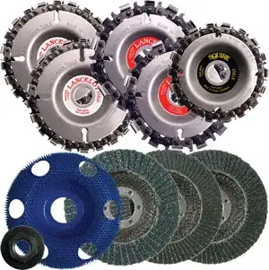

They are made, they look like mini chainsaws and are commonly used for carving bowls.
Lancelot and Discs
A common brand for these blades is Lancelot

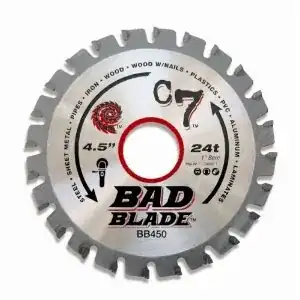

You can also get smaller saw blades in the 4.5" form factor. I suggest you go to a saw store or woodworking shop. Here is a product on Amazon:
http://www.amazon.com/KwikTool-BB450-2-Inch-1-Inch-8-Inch/dp/B000O3IOEW/ref=sr_1_2?ie=UTF8&qid=1357252670&sr=8-2&keywords=angle+grinder+wood+blade
mini saw blade

The primary reason is grinders typically spin at 10,000 rpm. Wood cutting saws typically spin in the 3500 to 4000 rpm. If you spun a typical circular saw blade at 10,000 rpm it would come apart. As @Matthew PK has shown they make wheels for working wood with a grinder but they are not the typical toothed blades.

Just use the chain saw type 4 inch blade shown above. They fit in the grinder perfectly, still have the advantage of the safety guard to protect you and have the added advantage of the guard deflecting the chips away from your face. I use them all the time and have done so for about ten years. You sharpen them like a chain saw with a file right on site if you like and the chains are replaceable when ever you want. I have a milwaukee 5 inch cordless grinder that runs it great and it will cut through a 2x6 in about 30 seconds. It is the tool made for the job unlike the jerry rigging ideas presented by some and costs less. Amazon has them for $15-40. Home depot sells them for a little more in the tool area too. A plate or biscuit jointer blade costs that much or more sometimes.
