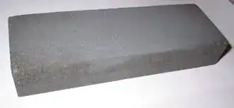

Sharpening is where the edge itself is prepared for use. The edge of a cutting tool is where its thickness is reduced gradually to almost nothing (almost because it still needs strength at the very edge, and where there is no material left it cannot give strength!). A general rule that I use is that if a tool makes sparks, it is too hot for sharpening. I prefer a flat stone like this:
Stones like these can be found in hardware stores all over the Americas, and probably wherever else people use knives. They are usually made of resin-bonded aluminum oxide or silicone carbide grits. You can use them with water or oil as lubricant, or dry. An important advantage of these stones over the Dremel grinder (beside not endangering the temper) is that they are wide and long enough to help you keep the angle of your tool with the stone. I often use finer stones after the one pictured, but this is good enough for many uses.
