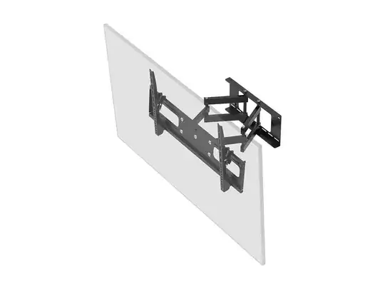

You could upgrade to a sturdier mount rated for yet more weight, (increasing the safety factor) and perhaps of a more robust design (i.e., mounts with two sets of arms holding the TV, rather than a single arm) if it would provide "worried parent peace of mind" (albeit at some cost.)
Twin Arm Mount image from Monoprice. I have bought things from them, but no other association / no endorsement intended
