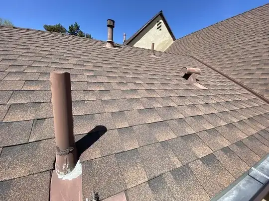

UPDATED WITH PHOTOS: Here you can see multiple vent pipes. I snaked both the close one and the far one. Time will tell if it worked Photo of the roof above the addition, multiple vent pipes

Even if someone was "working on the sewer lines with a vacuum" properly sized and functional vents would keep the traps from siphoning.
So, you have vents which are not functioning as they should, whether from being built improperly in the "new addition" (since the problem is limited to there) or from some sort of blockage (animal nest in the vent pipe or the like.)
You, or, if that's not your thing, someone you hire should get up on the roof and check the vent pipe there, perhaps with a snake in hand to try cleaning it. Dumping a bucket of water down, or running water from a hose down can also sometimes be helpful in identifying a blockage (and can sometimes help to clear it.)
After that you (or someone you hire if it's not your thing) would get to checking and using all the cleanouts down inside the house, if the problem persists. For a typical venting setup with a single toilet, the fact that the toilet is affected points to the main vent (for this section of the house) being blocked, not just some tributary branch vent.
Check your roof vent for obstructions (leaves, acorns, animals) by running a drain auger (snake) down the vent.
If it's clear (open) it may be an undersized vent or one that isn't located properly.

We had exactly the same issue, toilet and bathtub sucking air whenever one or the other was draining. We also thought the vent stack was the problem, and opened the stack up under the roofline (as it was winter and our roof was snow-covered) to eliminate the possibility of a blockage in the vent. That didn't improve the problem. The complete fix turned out to be the removal of a clog (using a roto-rooter) about 10 meters down the drain line (almost at our property line). Once gone, no problems since.
